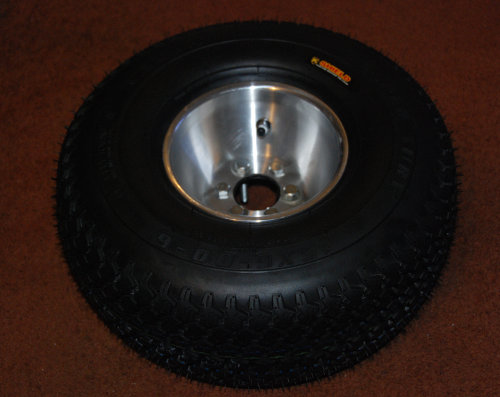

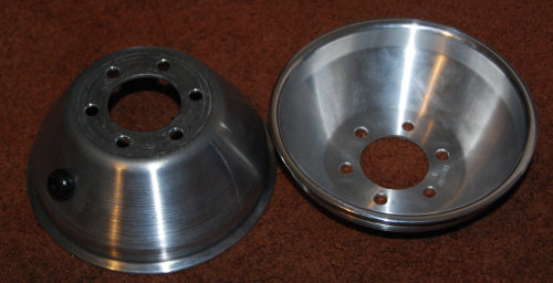

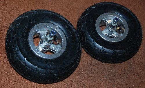

So far I've assembled one of the wheels with the spun aluminium hegar rims and neoprene seal inbetween and it seals up OK. I've also made the quick release blocks, so that I can remove the wheel/motor asssemblies from the rest of the chair when dismantling it. I'm currently working on the front forks for the 10" diameter front wheels.
I'll add images as I get parts made, and some pictures of the finished chair when I get that far - at the moment the plan is to finish it by Christmas, so that I'll be able to get out and about with a bit more grip when the snow/ice arrives.

Some of the bits and pieces:
Rear Rims, Hegar 2 x 6" Spun Aluminium Half 2.5" (2 off) and Hegar 2 x 6" Spun Aluminium half 2" from Hegar (USA) www.hegar4.com , £113.46 including delivery and duty:

Rear Tyres, 2 x 15x6.00-6 4 Ply Kenda K500 Super Turf with K-SHIELD from allterraintyres.co.uk, £85.90 including delivery, shown inflated with Hegar rims fitted:

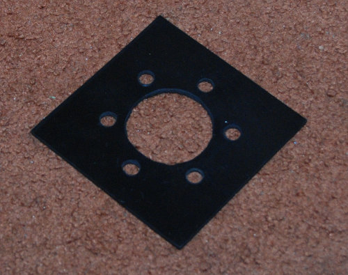

Gasket for Hegar split rims, 2 x Rubber Sheet 3mm Smooth Finish Neoprene 100mmx100mm from ebay(parki.babs2012), £2.54 including delivery, shown cut ready for use:

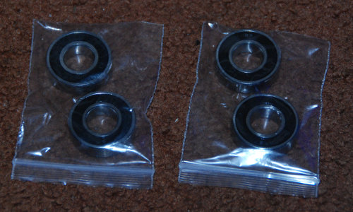

Bearings (for castors),4 x Bearing R8 2RS SS 1/2 X 1 1/8 X 5/16 STAINLESS R82RS SS from ebay(bearingoptions), £22 including delivery:

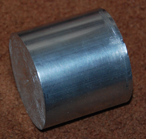

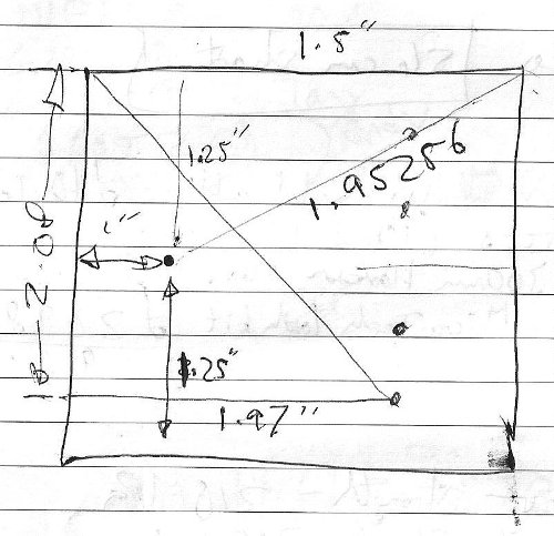

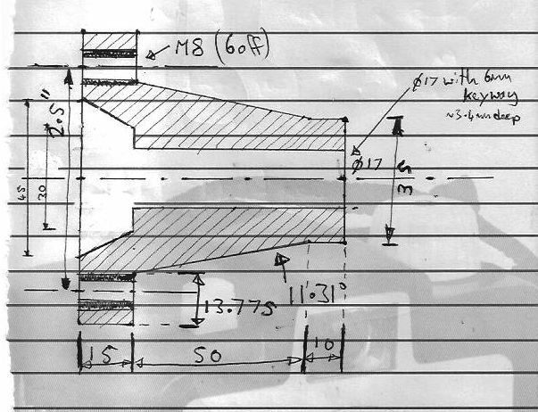

Hub drawing - done at a scale of more or less 1:1
This is a drawing I've done for the hubs to mount the rear wheels, I'm making it from aluminium - I'll cut the centre hole with a milling cutter, to get an accurate 17mm diameter hole and use a 6mm square HSS tool mounted on the toolholder on the lathe and move it in and out of the 17mm hole slowly cutting the keyway (with the 4 jaw chuck locked in place, so it cannot rotate) - the reason I'm using a 4 jaw chuck is because I cannot reverse the jaws on my 3 jaw chuck and the workpiece is too large to fit otherwise.
The actual depth required for the keyway is 2.5mm and that depth provides a tight fit on the axle shaft. (added 15/03/2014)
I'll try and add more drawings later.

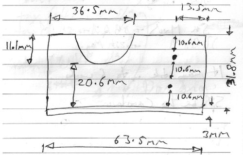

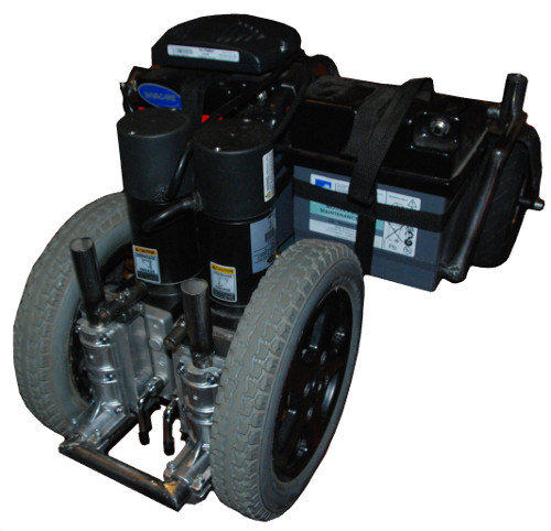

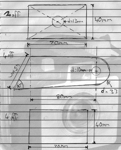

These are some drawings of the quick release blocks - sorry they are a bit rough, but they were only done in rough in a notebook, then scanned, the aluminium part replaces the motor position and is clamped with bolts to the frame, the steel part is bolted to the motor. The two parts are held together with a pair of 5mm rods with a vertical tube welded to one end to hold the two together - I'll post pictures of the completed blocks later, which should make this clearer.
This drawing shows an end view of the aluminium block showing where the holes need to be drilled - the block was then sawed in half - on the drawing that would be a horizontal cut half way up:
Another drawing showing the position of the holes in the aluminium block:
This drawing shows an end view of the steel "U shaped" part, the bottom 3mm is the thickness of the steel:
After cutting the aluminium block in half (carefully with a hacksaw), the six mounting holes were drilled to match the actual motor and counter bored to allow for the heads of the bolts using an end mill.

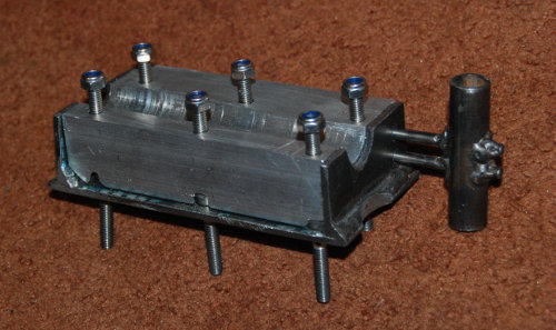

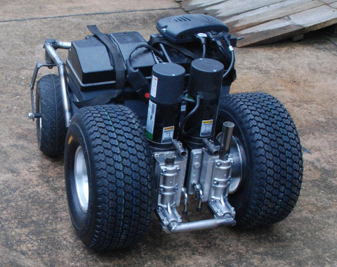

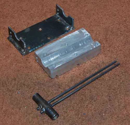

These are a couple of photos showing what the quick release blocks look like:

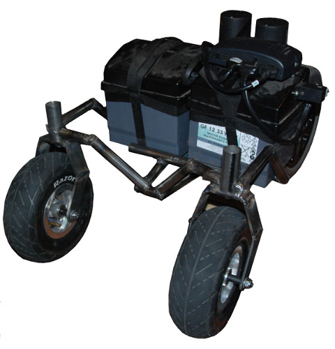

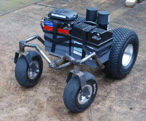

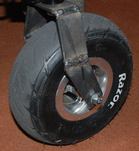

The front wheels need new forks as they are wider and a larger diameter, the forks have been made from 5mm mild steel plate:
After welding and fitting to the current chair:

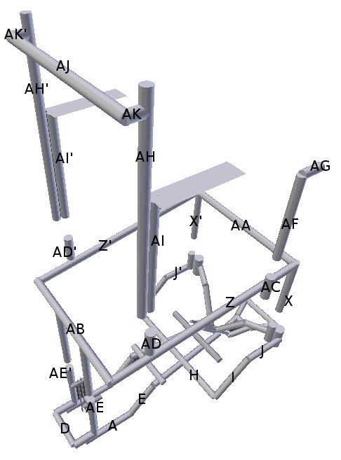

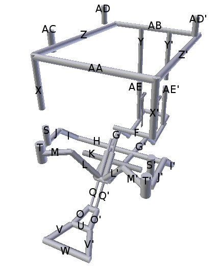

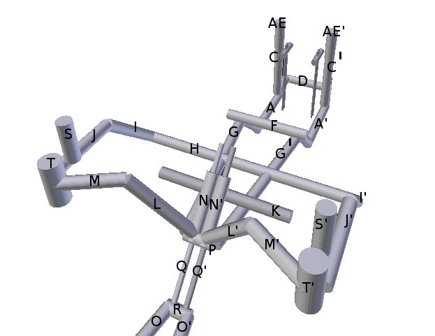

The tubular steel frame is made up mostly of 7/8 inch diameter steel, the bits that make up the frame are as follows:
Diameter Length Cut angle 1 Cut angle 2
A Cylinder.003 0.875 7.35 90 45
A' Cylinder.002 0.875 7.35 90 45
B' Cylinder.061 1 3 45 up 45 horizontal
B Cylinder.062 1 3 45 up -45 horizontal
C Cylinder.001 0.875 5.5 90 45
C' Cylinder 0.875 5.5 90 45
D Cylinder.004 0.875 5.2 45 -45
E Cylinder.006 0.875 5.2 45 90
E' Cylinder.005 0.875 5.2 45 90
F Cylinder.036 0.875 7 90 90
G Cylinder.008 0.875 12.795 45 down -40 horizontal
G' Cylinder.007 0.875 12.795 45 down 40 horizontal
H Cylinder.014 0.875 16.945 45 -45
I Cylinder.027 0.875 6.681 90 45
I' Cylinder.029 0.875 6.681 90 45
J Cylinder.028 0.875 5.598 45 down -45 horizontal
J' Cylinder.016 0.875 5.598 45 down 45 horizontal
K Cylinder.037 0.875 10 90 90
L Cylinder.033 0.875 6.33 90 45
L' Cylinder.034 0.875 6.33 90 45
M Cylinder.031 0.875 4.438 90 45
M' Cylinder.032 0.875 4.483 90 45
N Cylinder.030 0.875 4.5 90 90
N' Cylinder.015 0.875 4.5 90 90
O Cylinder.018 0.875 3.346 45 90
O' Cylinder.017 0.875 3.346 45 90
P Cylinder.009 0.875 2.114 50 -50
Q' Cylinder.010 0.394 10.5 90 90
Q Cylinder.011 0.394 10.5 90 90
R Cylinder.019 0.875 1.75 45 -45
S Cylinder.038 1 3 90 90
S' Cylinder.039 1 3 90 90
T Cylinder.021 1.4 3.15 90 90
T' Cylinder.022 1.4 3.15 90 90
U Cylinder.020 0.875 2.912 90 90
V Cylinder.035 0.875 4 60 30
V' Cylinder.013 0.875 4 60 30
W Cylinder.012 0.875 7 30 -30
X Cylinder.042 0.875 8.038 90 90
X' Cylinder.043 0.875 8.038 90 90
Y Cylinder.045 0.875 9.35 90 90
Y' Cylinder.044 0.875 9.35 90 90
Z Cylinder.047 0.875 23.388 45 -45
Z' Cylinder.048 0.875 23.388 45 -45
AA Cylinder.071 0.875 15.946 45 -45
AB Cylinder.046 0.875 15.75 45 -45
AC Cylinder.059 1 3 90 90
AD Cylinder.055 1 3 90 90
AD' Cylinder.056 1 3 90 90
AE' Cylinder.040 1 3 90 90
AE Cylinder.041 1 3 90 90
AF Cylinder.058 0.875 9.375 90 45
AG Cylinder.060 0.875 2.25 45 90
AH Cylinder.049 0.875 19.5 90 90
AH' Cylinder.050 0.875 19.5 90 90
AI Cylinder.054 0.875 11.5 90 90
AI' Cylinder.057 0.875 11.5 90 90
AJ Cylinder.051 0.875 15.75 45 -45
AK Cylinder.053 0.875 1.375 45 90
AK' Cylinder.052 0.875 1.375 45 90
Drawings showing the location of each piece are below:
The overlap of tube A and B ( also A' and B') is 1.75 inches - this could vary, depending on what motors are fitted.
The distance from the centre of F to the centre of H is 4.5 inches and from the centre of F to the centre of K is 8.35 inches. This should leave a suitable gap for the batteries.

Post by admintrev » Sun Jan 19, 2014 11:58 am
The new front forks and tyres are being tested on a standard chair as the new frame isn't finished, after accidentally running one of the front wheels along a raised surface (the rest of the chair bieng on the flat) the top section of the front fork (5mm steel plate) became distorted either side of where the bolt goes through it. Therefore I'll be welding an addtional piece of 5mm plate under each of top bits of the front forks to reinforce them - this will hopefully make them strong enough.
The front bearing housings still needs machining on a lathe, however I've done an assembly test showing the fitting of the front wheels etc:

Post by admintrev » Thu Mar 06, 2014 6:53 pm
The aluminium hubs are still a work in progress (the keyways need cutting and then then they need reducing in size [to save weight]).
The photos below show the aluminium hubs in use (non-functional as the keyways still need cutting) along with the rest of the frame assembled to verify the cutting length for the vertical elements to support the seat structure:
The frame including the aluminium quick release blocks and the front wheels is currently 10.1kg and the front footrest still needs attaching.
Once the chair is complete, it may be worth re-making the back section of the frame as when it was initially welded, some problems with the welding were encountered and so extra weight was added that shouldn't be there, re-making that section is likely to reduce the frame to the 10kg target weight.
The two wheel/motor assemblies have been weighed at 9.8kg and 10.1kg (one of them is longer than the designed width and needs cutting down slightly) and once they have been turned down to the designed shape the assemblies will be considerably less than the target weight of 10kg.
