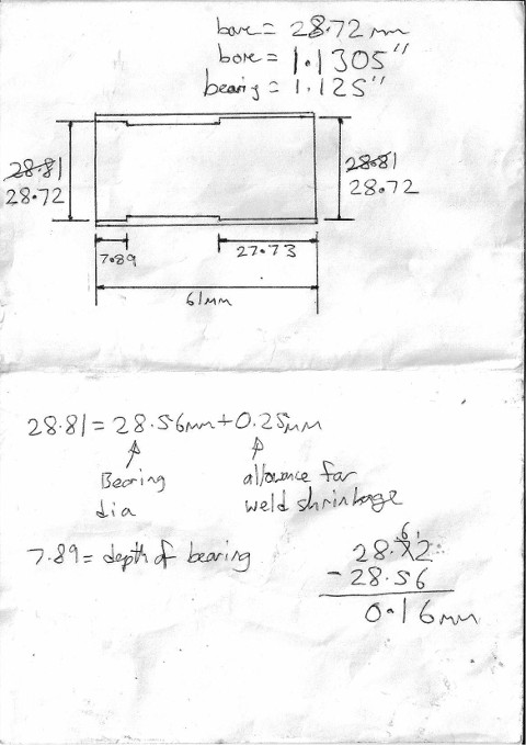

Below is the drawing for the two bearing housings:
The bearing clearance is to allow for distortion whan the housings are welded into the frame. After welding the bearing housings into the frame it was found that a small amount of filing was required at the top where the metal had melted and was obstructing the bearings from being pushed in. Once enough clearance had been provided to allow the bearing to drop in the first 4mm or so they could be hammered home using a ring spanner which was of a suitable size to push just the outer ring of the bearing into the housing. The lower bearings are now a tight fit after welding and will need some bearing loctite to stop them rotating when in use.

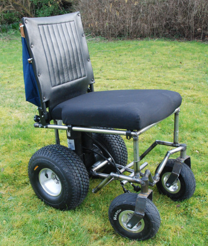

A trial assembly was carried out to ensure that the batteries would not rub on the tyres when the chair is in use. an additional cross-member has been added behind the batteries as they were rubbing on the rear tyres.
After the trial assembly it was decided to tack on the footrest as a temporary measure to check the position - The chair is now useable , although the footrest bracket still needs finishing and swapping with the temporary tube currently holding the footrest in postion.
The photo below shows the chair as of 29/03/2014:

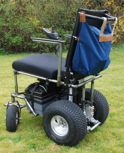

Lessons learned etc:
Some parts on the chair didn't work out as well as hoped:
1) The motors had more movement than I liked because of the quick release blocks and as I wasn't using them to dismantle the chair I have removed them and attached the motors directly to the frame. I'm not sure if it was a design issue or the way I made them - although I think there were issues with both.
2) I don't believe the motors are designed to be used in the vertical configuration and I've had some issues with leaking oil and one of the motors making noise.
3) The top plate of each of the front forks is made from 3mm steel, which is too thin (I should have used 5mm) and I've had problems with it bending, although because there is a lot of clearance around the front wheels it hasn't caused any problems.
4) The retractable footrest as originally designed wasn't supported well enough and eventually one of the welds at the bottom broke, I re-welded it and also welded the two rods together at the top (where the nuts are), this made it a lot stronger and I've not had any problems with it since.
I've now made a back rest and back rest brackets, I also used the backrest material from a donor chair (which includes a large pocket at the back held shut with velcro).
The original blue bag is now tucked under the seat at the front and provides quite a lot of storage.
I've made a ramp that I hang off the arm of the chair, which is useful where there isn't any disabled access - I'll try to get some drawings done for the website.
At some point I'll cut off the foot rest and re-weld it without the retractable part, so as to not impinge on the storage space at the front - although the retractable bit does work I haven't found it particularly useful as my feet overhang the front of the footrest.
I've made a couple of aluminium battery boxes each holding 8 Headway LifePo4 40152S 15Ah cells which are temporarily hung just under the seat - I still need to make a steel frame attached to the underside of the seat to support them.
Because the standard wheelchair motors get very hot when used for more than a short period and are not really powerful enough I have purchased a couple of 750W 24V 4 Pole industrial motors (similar to the attached image), which I imported direct from China, these are designed to run 8 hours a day 365 days a year - so should never overheat with the use I'll be putting them through.
I also tend to get wheel-spin on uneven surfaces and so have decided to add suspension which should increase traction.
The new version will have one motor in the vertical configuration and the other sticking forward at a slight upward angle - the motors will overlap with each other, but even so the overall width will need to be increased by approx 1cm.
The way the new lower frame will be dismantled is using two sizes of box section with one sliding inside the other one in front and one behind the motors (the motors will act as part of the frame), then the vertical motor's gearbox will be attached to the front section via a pair of box section pieces which will slide inside another pair, which in turn will be welded to some large box section which will attach to the inner bolt of a pair of large bearings centrally located near the front of the chair, the outside housing of which will be attached to the front section of the frame. At the back will be a pair of spring/shock absorbers (normally used on mountain bikes) attached to the bottom of the seat, the bottom of the shock absorbers will be joined to a cross bracket which will drop into square section pieces attached to the rear motors.
Because of the size of the new motors the motor/wheel assemblies will unfortunately be more than 10kg each.
I've got more or less all of the bits to re-engineer the chair, however it will take me months to get it sorted out, I'll try to get some drawings and photos to update the webpage some more.
