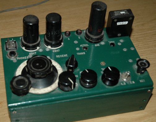

Built this one sometime ago, maybe you would like to post a pic? Working like a charm! (chirpy does it!) 73 Raoul, ZS1REC
Comment from G3YVF
May I say that if you are not worried about the receiver coverage suffering from the original range you will find the performance of the receiver will really be enhanced if you bandspread the tuning. It becomes really good to use like this and pulls in signals with ease. This is done by using roughly 20pF to tune the 80m band. To do this means a little more fixed capacity across a coil of fewer turns. However the rx performance is really enhanced.
Your chirp could be down to a dirty crystal....but if most crystals do this try a gimmick capacitor from anode to grid1 if you use a circuit without an rfc in the cathode. If you do use the later circuit where a cathode rfc is used then try a gimmick capacitor from g1 to cathode. The rig should not really chirp and most times does not...although some operators listening for a paraset can pick them out!.
