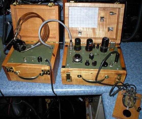

The set from Mike WA8YWO
The above set is used on 160 meters only and works great but I have another one is just like it and is for 80 meters only. I set the band spread on both sets to operate only in the CW bands.
Using that band spread setup, tuning is very comfortable and there is no need to touch up the regen under normal conditions.
The only noticeable difference between the two sets are the handles on the face of the 160 meter set.
I usually see about 3 watts out of the sets with about 350 volt HT.
Lately I have built a different power supply giving only 210 volt HT and I am measuring less than a watt .
I like operating at a lower power level. I normally use a full size dipole on both bands at about 12 meters above the ground. Everything worked the first time I turned the power supply on.
I did find that I needed to remove a few turns of wire on the receive coil antenna connection as the signals from the dipole were overloading the receiver on really strong signals.I have been very pleased with the sets.
I never operate anything but the Parasets these days. A couple years ago we put together a Paraset night in honour of D-day and I was amazed at the number of stations that were all calling at the same time at the scheduled time.
I have plans to reinstate coils turns that I removed from the receive coil and make an attenuator when using the dipole and then I can go out into the field and try some really short "long wire" antennas like the sets were suppose to use.
Every station that I have worked has always been very supportive of the venture .....
