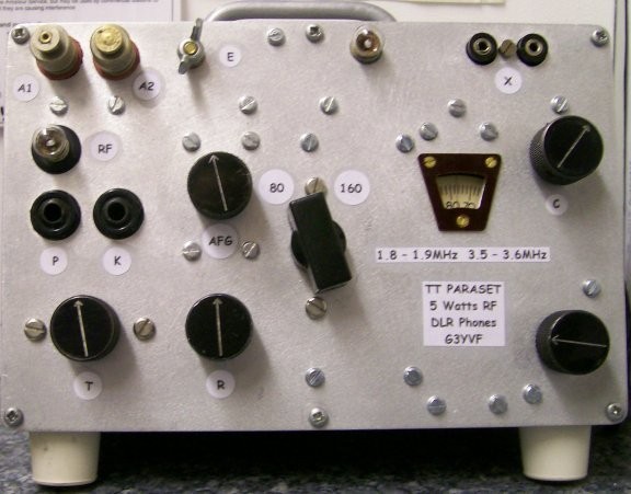

This is Adrian's TT Paraset built
with help from Geoff G3YVF. This one is made in a die cast box...very robust
and stable. You will also note it is a two band TT and it covers 80 and 160m.
This Paraset you will notice does not have a calibration chart.....that is
because this little beauty has the 0 to 100 dial calibrated exactly on 3.5
to 3.6MHz and 1.8 to 1.9MHz. Straight line frequency tuning and so the dial
reads out to 1KHz accuracy....no need for any chart!
The tuning capacitor is an ordinary tuning
capacitor (the sort used in the Paraset) and is 20pF. Full break-in...well
what did you expect!!
