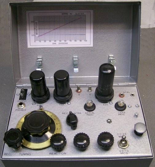

His replica valved Paraset and with its mains psu in the lower picture. It can be seen that this one is bandspread to cover only the cw portion of 80m.

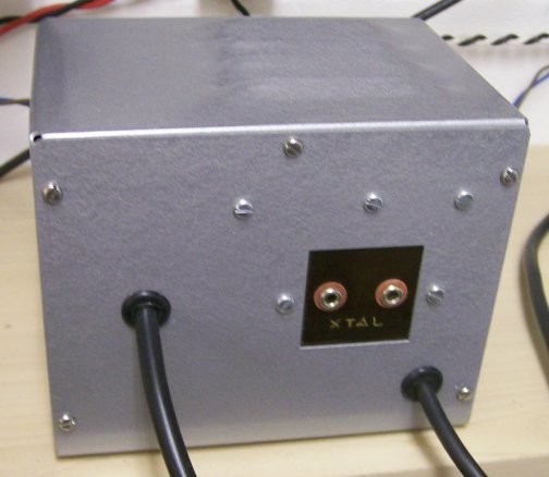

The mains power supply for the Valve Replica Paraset.
NOTE, in an original mains psu for the Paraset there is a mains tapping adjustment panel in the front...in the one pictured the space has been used to fit a XTAL socket, since within the psu is a crystal oscillator used for netting. A very handy feature!
