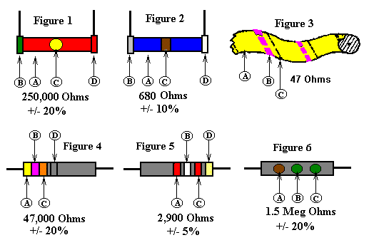

Arrangements Used Commercially for Marking the Color Dots and
Bands on Molded Fixed Resistors
- Figures 1 and 2
- (1) the first figure of the resistance value in ohms is
indicated by the body color (A) of the resistor.
- (2) the second figure is indicated by the color of one
end (B) of the resistor.
- (3) the number of zeros following the second figure is
indicated by the color of a dot (C) --Figure 1, or a band (C)
---Figure 2, at the center of the resistor. When no center dot or band
exists, it is to be assumed that the dot, or band is of the same color as
the body and the number of zeros is judged from that color.
- (4) The percent of tolerance of the resistance value is
indicated by another colored band (D) (either gold or silver) at the
other end of the resistor. In the absence of the tolerance band, the
tolerance value is assumed to be +/- 20%.
Color Coding of Flexible Type Resistors
Flexible fabric-covered wire-wound resistors are also RMA coded by three
identifying colors, the same as molded resistors. The method of
identification is as follows:
- Figure 3
- (1) the body color (A) represents the first figure of the
resistance value in ohms.
- (2) the thickest thread (triple thread) color (B)
represents the second figure.
- (3) the thinnest thread (single-thread) color (C) represents
the number of zeros following the two figures.
If either the thick or thin thread is missing, it is assumed to be there,
carrying the same color as the body.
Figures 4 and 5
The consecutive colored band arrangements shown figures 4 and 5 are a later
marking arrangement widely used on molded resistor--especially those provided
with axial-type pigtail leads. In the marking arrangement shown in figure
4, the three (or four) bands are arranged side by side with band (A)
indicating the first significant figure of the resistance value.
The band arrangement shown in figure 5 differs only in the position of the
bands. Here, the three bands are located off-center on the resistor with the
starting band (A) nearest the center. This really amounts to the same
arrangement as figure 4, with the bands shifted to the right so that the
tolerance band (D) is at the end. The band are read the same as figure 4,
consecutively--left to right.
Figure 6
Some molded resistors look like small, narrow, mica capacitors. These are
ordinarily RMA color-coded by means of three identifying colored dots placed
as illustrated in Figure 6. These dots are read in sequence A-B-C, in the
same manner as explained for the markings for Figure 4.
