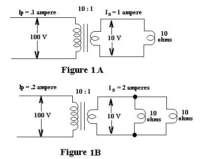

To keep the math simple, lets assume an output tube is supplying a 100 volt ac signal to the primary of an output transformer with a 10:1 winding ratio, and the secondary is feeding a 10 ohm voice coil (see figure 1A below). With 100 volts across the primary, there will be 10 volts across the voice coil connected to the secondary. Using ohms law, there will be 1 amp of current flowing in the voice coil.
I = E/R I = 10/10 = 1 ampereFor further simplification we will assume 100% efficiency in the transformer. Since we have a 10:1 ratio, the current flowing in the primary will be .1 ampere ( 1 amp in secondary divided by 10). With 100 volts across the primary, ohms law tells us that the primary looks like a 1,000 ohms impedance load to the tube.
Z = E/I Z = 100/.1 = 1,000 ohmsNow if we decrease the impedance of the load, what happens to the impedance in the primary? If we place another 10 ohm voice coil in parallel with the original one, we now have a 5 ohm load (see figure 1B below). Using ohms law again we see that the current in the secondary is now 2 amperes.
I = E/R I = 10/5 = 2 amperesThis means that the current in the primary also doubles to .2 amperes. Again using ohms law, the impedance of the primary is now 500 ohms.
Z = E/I Z = 100/.2 = 500 ohmsThis is called the reflected load. A 10 ohm load reflects back a 1,000 ohm impedance, while a 5 ohm load reflects back a 500 ohm impedance. The reflected impedance is a function of the turns ratio of the transformer. Notice that the ratio of the primary impedance to the secondary impedance is the square of the turns ratio, or 100:1. In other words, a 10:1 turns ratio will give an impedance ratio of 100:1.

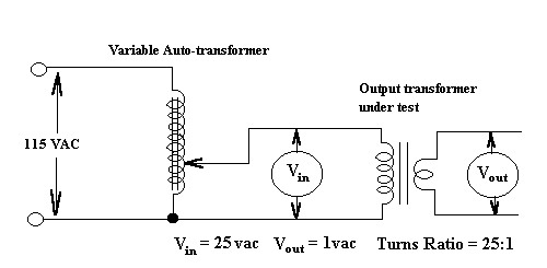

To determine the turns ratio we apply an ac voltage to the primary, and measure the voltage in the secondary. The voltage on the secondary will be stepped down by a proportional amount determined by the turns ratio of the transformer. Figure 2 below shows the schematic diagram of the test set-up. A variable auto-transformer (sometimes referred to by the brand name Variac) is used to apply the variable ac to the primary (see note below). An ac voltmeter is connected to the secondary to measure the output voltage. To make the calculation of the turns ratio easy, the input voltage is increased until the voltage on the secondary reads 1 volt. With the secondary reading 1 volt, measure the input voltage to the primary. Since the voltage on the secondary is set to 1 volt, the voltage measured on the primary will be the turns ratio. For example, if the voltage on the primary measures 25 volts, the turns ratio is 25:1 as illustrated in figure 2 below.
Note: An auto-transformer does not provide isolation from the ac line. For safety reasons, the auto-transformer should be used in conjunction with a 1:1 isolation transformer.
Now, armed with the turns ratio, we can calculate the impedance ratio and the impedance that will be reflected to the primary with a given load in the secondary. Remember we said earlier that the impedance ratio is the square of the turns ratio. With our 25:1 turns ratio transformer in figure 2, the impedance ratio is the turns ratio squared or, 25 X 25 = 625:1. So if the transformer is working into an 8 ohm load, the impedance that will be reflected to the primary will be the impedance ratio (625) multiplied by the load impedance (8 ohms), equal 5,000 ohms. If the load in the secondary is changed to a 4 ohm load, the reflected impedance in the primary would be 625 X 4 = 2,500 ohms.
